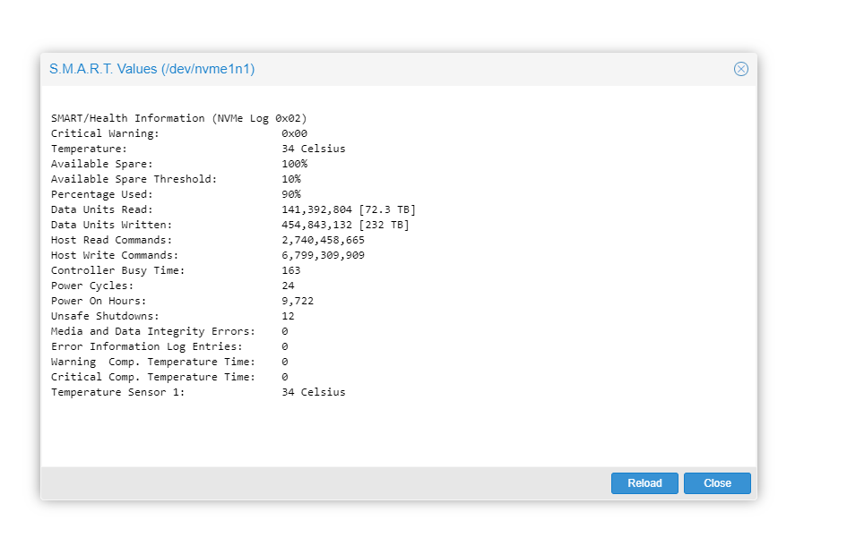

    @NoComment said:
    @Advin said: Not asking for Gen4 top tier disk speeds, but these are in RAID0 and should be performing much higher (on the website their rated spec is 1.4-2GB/s each).
    I think it may be due to lack of pcie 3 slots on the mobo, or maybe nvme inserted into wrong slots.
    Maybe, also these disks have extremely high wearout:
    Depending on which server you bought, different disks are used, in the cheapest servers there are also cheaper models of disks and that's why there might be such parameters. Please send us a ticket to [email protected] and we will check why.

  • Daniel15Daniel15 Veteran
    edited April 2022
    @Advin said:also these disks have extremely high wearout:
    That's... kinda impressive tbh. I wonder if the drive was previously used in a high-traffic write-heavy DB server, or something similar. More writes than reads, and 232 TB written over 9722 power-on hours is around a consistent 6.63 MB/s write rate for the entire time the drive has been powered on :open_mouth:
    It's very close to hitting the TBW rating for the drive, which is 330TB: https://www.goodram.com/en/products/px500-nvme-pcie-gen-3-x4-ssd/
    They replaced it with some fairly new Samsung 980 500GB models with only 5% wearout, which is good at least. I don't know (and don't think) they'll do it for everyone though.
    Someone I know also got a Mevspace promo server and had the same amount of wearout. I wonder if these are from Chia miners or something like that.
    After the replacement, I have been pretty happy with my Mevspace server. I had a small issue where the speeds to Google Drive were terrible, but support was able to do a temporary fix so that I can at least push 600-700 Mbps. However, I don't know if I will be renewing it since I had planned for this server to be pushing to Google Drive and I don't know how long it'll take them to fix it so that I can push the full 1 Gbps.

    After replacement disk (RAID0)
  • @Advin said: Samsung 980
    Sigh, every time I see a host using this shit, I want to hit them on the head. Consumer SSDs will wear out faster than an enterprise SSD, and will end up costing them in the long run. What were you expecting from a host that was fine with IP spoofing, anyway?
