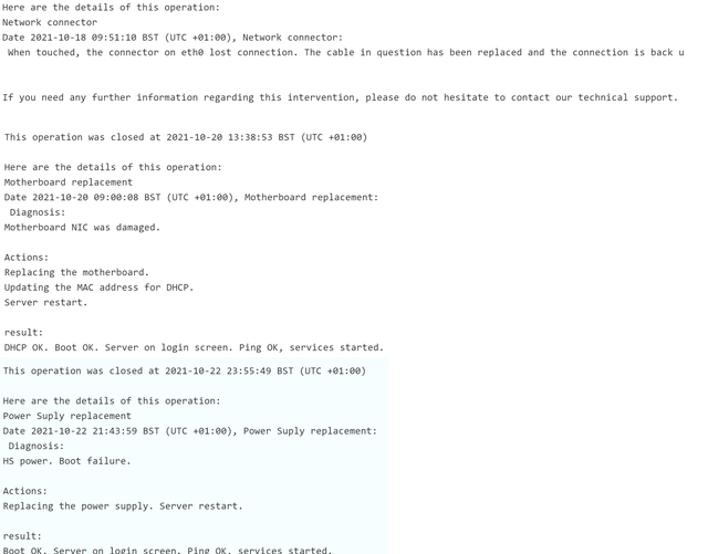

    From whois your IP, I guess you have a 51.195.48.96/28 subnet, with its gateway is 51.195.48.110.
    From your data, I assume your host gateway is 51.195.61.254.
    You have 2 ways to config your VM guests:
    • i. (OVH-natively) As I said in 2 previous posts, using 51.195.48.110 as gateway (you should read the email of IP allocation from OVH)
    • ii. (not OVH-natively) Using OVH-native ARP on host, and HOST IP as gateway on guests, by assuming whole subnet is pooled on host, in order that you use /32, but you need delete the virtual MAC address
    Florin is trying to use the first IP .96 on a VM.
    Would it ever work?
    I think it's possible to get it working, given that it works when configured on the host.
    @bsh @yoursunny thank you for help!
    You figured our correctly, that's the FO allocation but I main server has different IP than 51.195.48.XXX.
    You said correctly, .110 will be gateway for .224 subnet but I use exactly same DHCP configuration for 51.75.158.48-63 (again /28) and have 4/4 successfully sent requests to all IPs within this range.
    Best regards, Florin.

    @yoursunny said:
    Would it ever work?
    Yes, it works if using with virtual MAC. For guest machines, OVH /28 has 15 usable IP's (need to create virtual MAC), except the gateway. For just IP-aliasing on the host machine, OVH /28 has 16 usable IP's (no need to create virtual MAC).
    You mean that you have one (1) dedi with two (2) subnets of /28 size, and I guess it's a SyS server, not OVH.
    OpenStack seems not to support fragmented subnets, unfortunately. If so, you would have to create a virtual network for bridging your two subnets to the host. Otherwise saying, try creating multiple floating IP pools on your neutron router and bridge your virtual network to the physical network to enable connectivity to and from virtual instances.
    Conclusion
    OVH really does a blunder when changing your hardware, because it's not the hardware-related issue.
    SYS is not ideal for running OpenStack when comparing to OVH on the cost-effective side (16 free IPs vs 254 free IPs).
    Thanked by 1FlorinMarian
