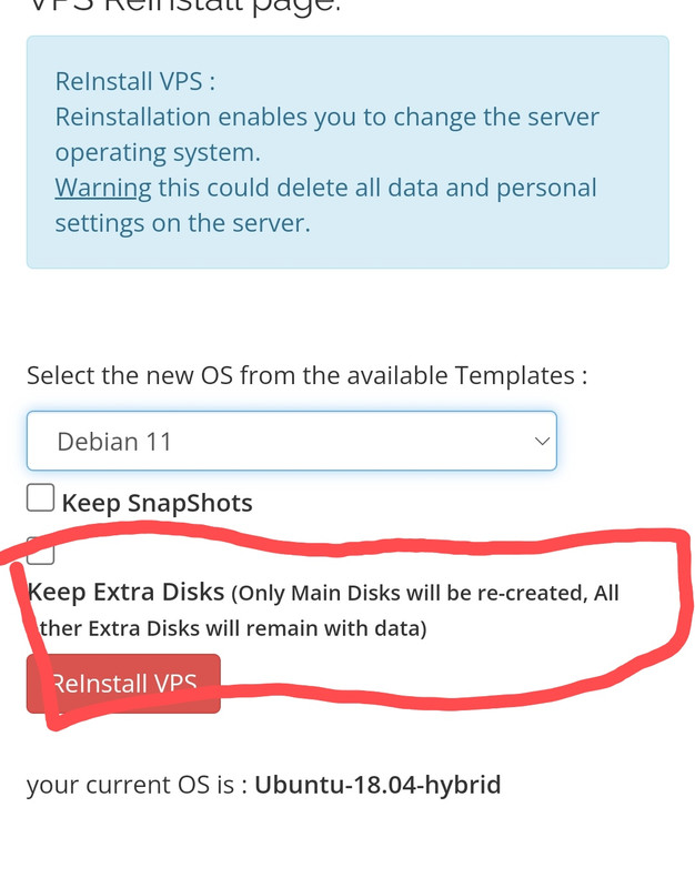

I needed your help i have servarica Salamander Hybrid SSD and storage 4tb
I want to change my is from Ubuntu 18 to debian 11...i have data installed in HDD...how can I safely install new os debian 11 without hurting my data on HDD

    I am seeing this option on thier site... should I select it...or unmount 1st??
    If unmount then please any specific code

    the safest way is that we will give you another vps you can install your os of choice into then you manually move the data from old to new
    the option to keep extra disks depend on how your vm disks is configured
    the idea is that for windows VPS for example we configure it as 2 separate disks which means using this option you will only reinstall the OS disk and the remaining disks will be reattached to new VPS
    if you see all your disks as 1 big disk this option will not be useful
    just wait a bit and one of the admin will create new vm for you to move your data (free)
