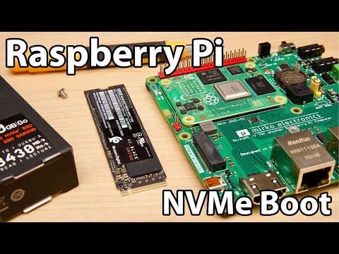

    If you dont need much performance then save money and go with Raspberry Pi4 4GB and connect SSD via USB3. You can also try to get NVMe SSD and connect it like this

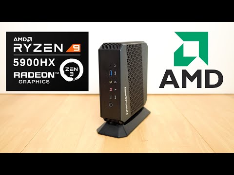

    I'm thinking of getting this beast, but for personal use. It is a serious 8c/16t beast!
    It would work fine for your use.
    Why am I just now seeing this!?!!
    Droooooool. :-) That is one serious little mini-beast alright!
