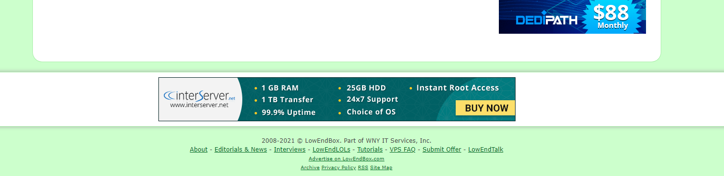

Recently something changed that caused the footer on LowEndBox (on pages other than the home page) to be displayed improperly.
Example of the correct visual design on the home page: https://lowendbox.com
Not correct: https://lowendbox.com/blog/lowendboxtv-fire-up-wordpress-in-only-3-commands/
Can anyone help me understand what might be causing this?
Using archive.org it seems something changed a few days ago, but I have no memory of changing anything that would cause this change.
Any input from our local coding experts here would be appreciated :)

    Another question, any suggestions on how I can make the footer on LEB more responsive for mobile viewers?
    ^^ That's on desktop, which looks and works fine. However, on mobile, it's horrible.

  • First I would suggest to set correct width for footer banners🙈
    Just set width: 100% for the div class and the issue should be fixed
    I see this in the CSS:
        .footimg a img {   width: 100% !important;}
    And here is the footer code. What am I missing?

    I changed it to:
        .footimg a img { max-width: 100% ;}
    And it doesn't seem to have had the intended impact. The footer is still way to wide for the view on mobile. Any other ideas? Am I doing something wrong?
