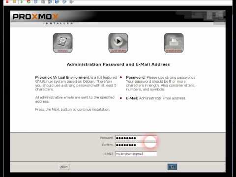

  • earlearl Member
    edited November 2013
    Ok here is the steps..
    first you download proxomox from here:
    http://www.proxmox.com/downloads/item/proxmox-ve-3-1-iso-installer
    Once you download the ISO, you need to burn it to a cd and load it to the cdrom of your server, then you can follow the instructions on the video:
    After the proxmox install is complete then you proceed to change the repo from the default enterprise (paid) to the No-Subscription (free) so that you can update your proxmox server, following the instructions for "Proxmox VE No-Subscription Repository"
    http://pve.proxmox.com/wiki/Package_repositories#Proxmox_VE_No-Subscription_Repository
