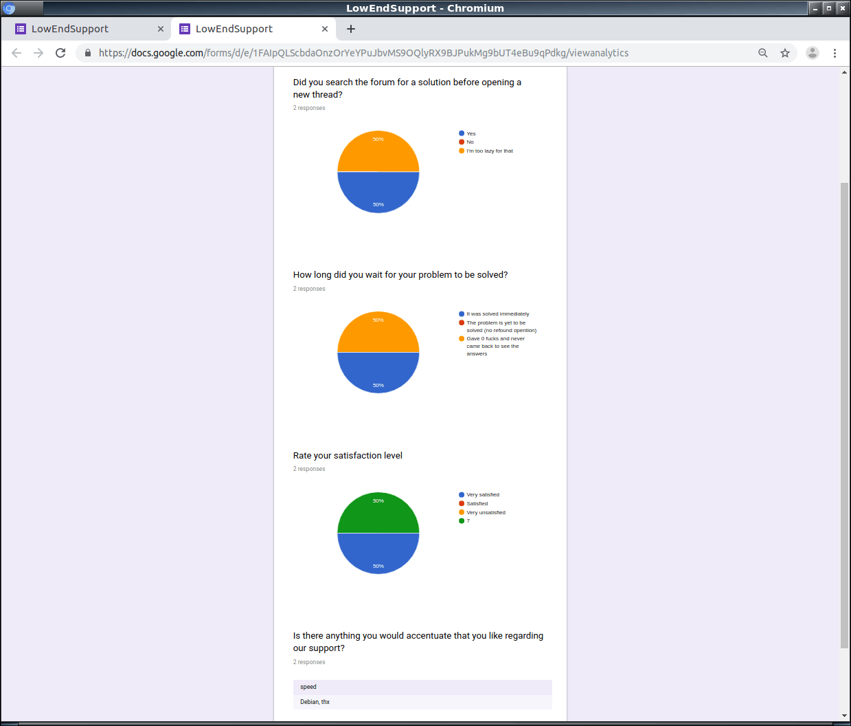

  • C'mon guys... it's a serious survey.

  • @farsighter said:
    Anyway @uptime obviously put a lot more effort into explaining you things so he should be the winner.:)
    @uptime please receive my heartiest congratulations on winning the "Great Answer Award".
    This is a tribute bestowed only on those who are recognized by the Academy of Low End Talks for their effort, dedication, energy, sacrifice and skills.
    This trophy acknowledges how it is good to have someone of your caliber here.
    Keep up the good work and may God bless your heart.
