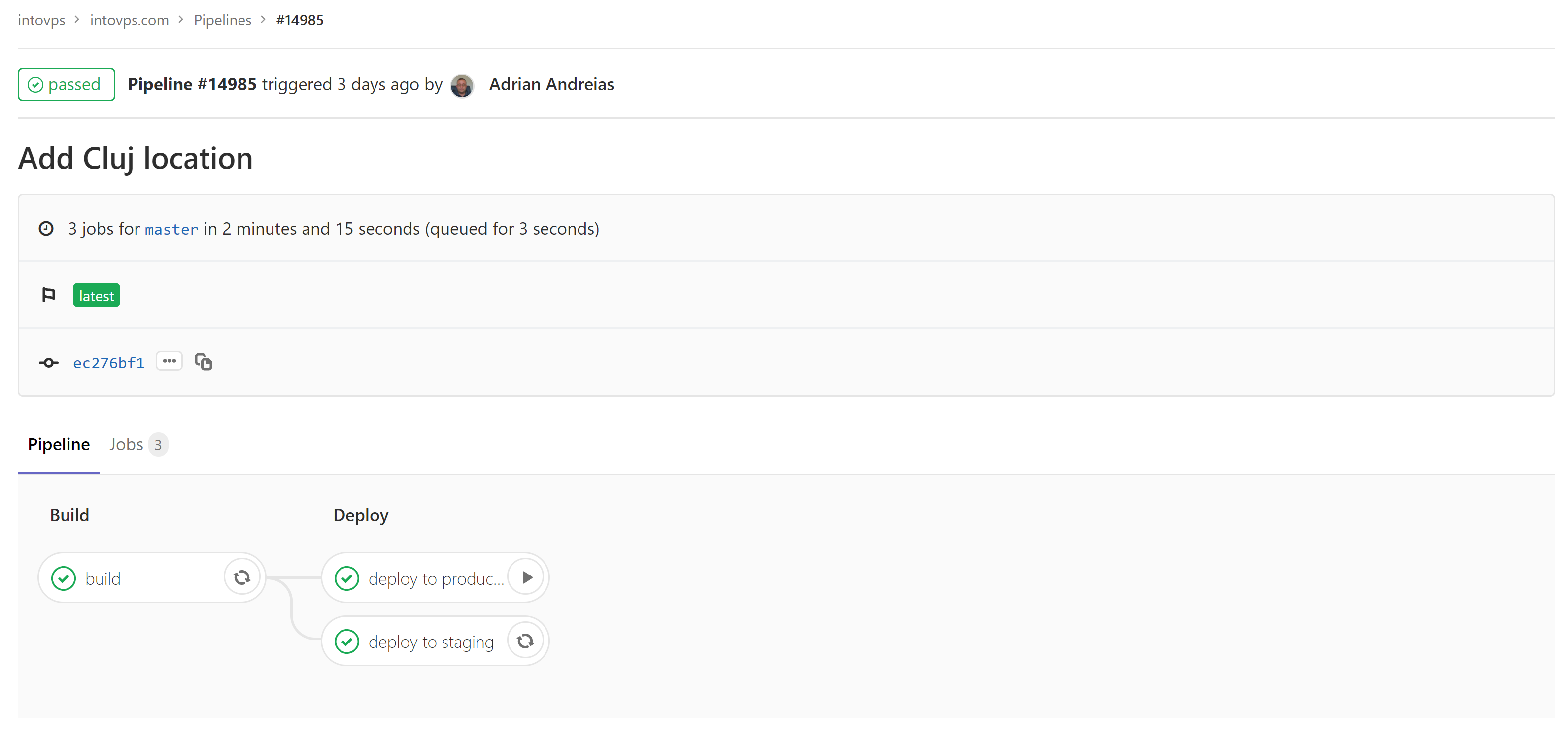

I love their CI/CD/devops pipelines system. When we push a commit on one of our Jekyll based sites (fleio.com, intovps.com, hosterion.com or hosterion.ro) the build starts automatically and automatically pushes html files to an internal staging website. After we check changes one more time in browser we push a button and htmls are deployed to production:

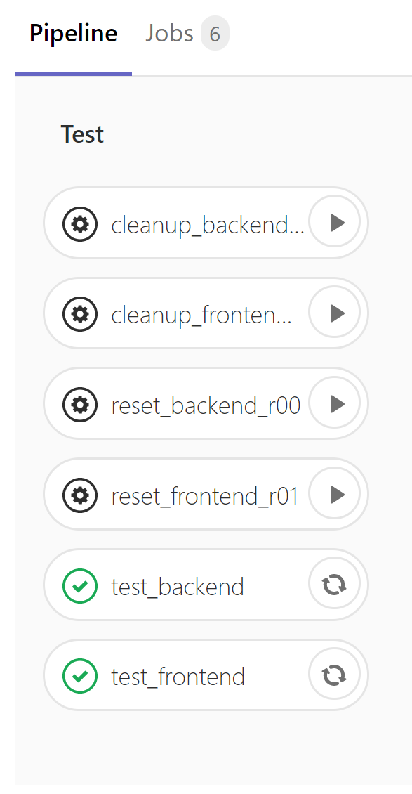

Same automation with Fleio git pushes on deve branches trigger the automatic tests:

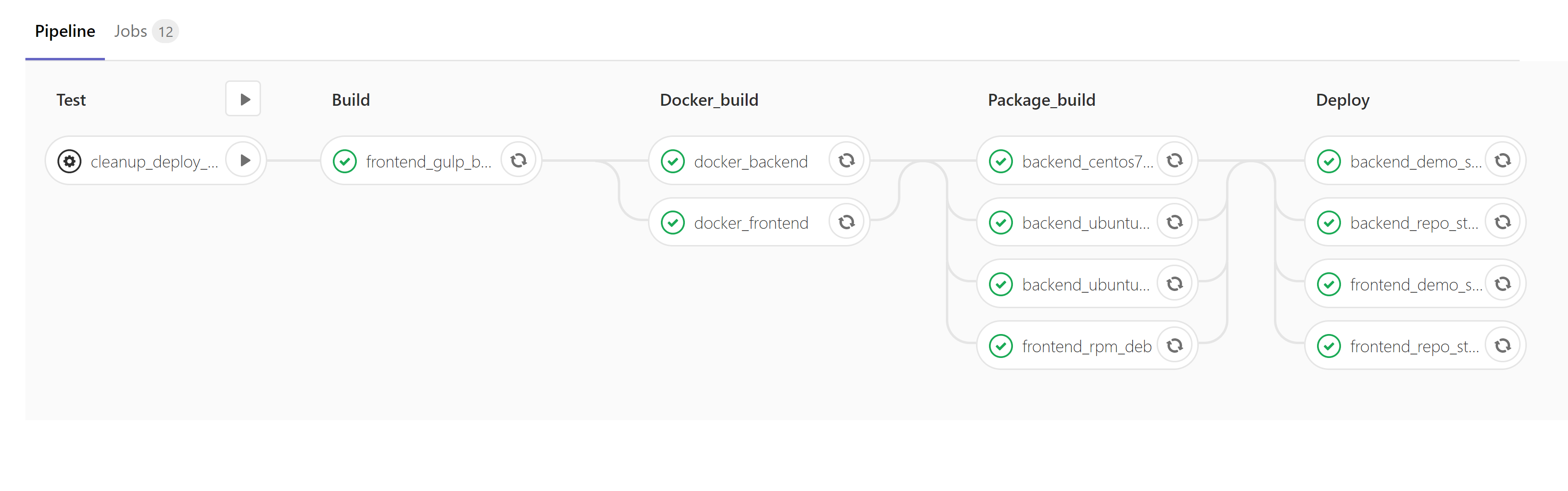

Or more elaborated jobs flow that build rpm/deb/docker images, upgrades OS packages on staging servers, pushes to OS repo and Docker public registry:

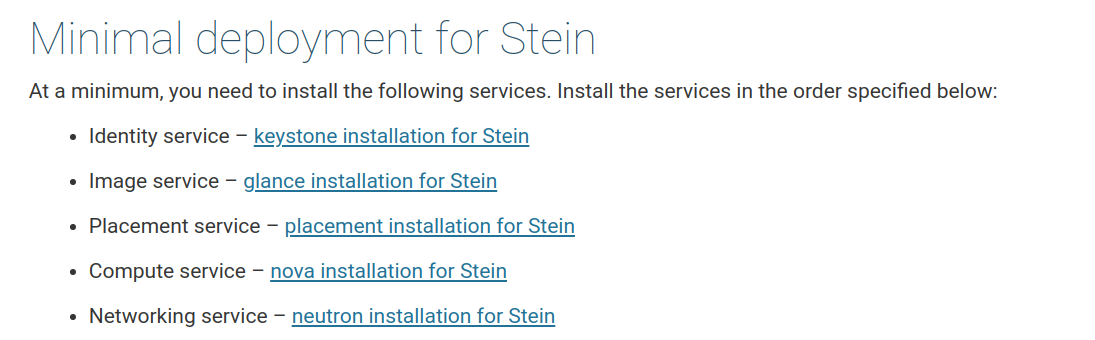

@fleio super interesting and I kinda like Fleio. The only issue is the Openstack installation to get it all working. I dont even know where to start. Its built using many components then you need to interconnect those but what, makes you think you need like 4 or 5 dedicated servers just to power Openstack.
