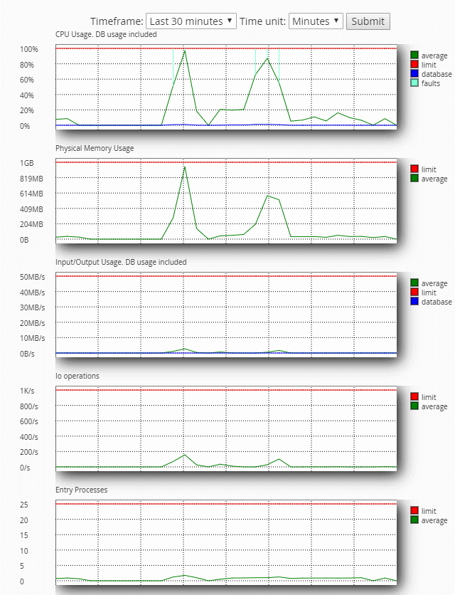

    Thank you @smallbibi for the reply. If it helps any further considerations, here are the stats of a server where a reseller account is hosted:
    And here are CloudLinux resourse usage stats for a particular WordPress website with over 1000 daily visits and, I assume, properly optimized, plus using LiteSpeed cache (flat line is after migration off a previously used server):
    And more recent, 24 hour stats from a server where it's currently hosted:
    Stats of a poorly optimized WordPress website when updating a post (no visits):
    Based on this, if I understand correctly, it appears that, with WordPress, CPU is the most "loaded" resource, hence most likely to become the bottleneck.

    bikegremlin said: Based on this, if I understand correctly, it appears that, with WordPress, CPU is the most "loaded" resource, hence most likely to become the bottleneck.
    Most of the time yes, CPU is the bottleneck for wordpress. But even more so in shared environments. The biggest problems you face with wordpress are when playing with its backend or when you have tons of plugins.

    bikegremlin said: Another assumption I'm yet to further test and confirm, is that hitting either RAM, or CPU limit (within CloudLinux) gets a WordPress website temporarily down, while hitting I/O limits usually just slows it down, without any errors (when updating posts, categories etc.). I was expecting only RAM limit to cause a "website down". Not sure if it depends on a particular server setup by the hosting provider.
    To me, cloudlinux is a black box and I don't know it's inner workings so I can't say for sure. But normally, exceeding your cpu limit just means having a high load so things slow down. Not having enough ram will show errors on your site.

    bikegremlin said: We still in a 30-50 or so area with a 2 vCPU - 2 GB RAM VPS?
    Yes, in fact that 30-50 area might be achievable on 1 GB of ram but things could be slow since you will need to use swap. In case you don't know what swap is, its using your disk as 'ram'. But when I said these things, I was thinking of using nginx and not using any panels.
