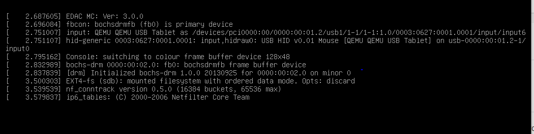

trying Hetzner Cloud and used IPTables. It seems that they use DHCP to provision each Cloud-Instance every boot with an IP. So even though i've enabled DHCP (67,68), the instance still does not receive an IP. Without firewall, everything is smooth [..].
Any ideas?
Regards
  • Cloud-Init hangs here.
  • I know it works with https://wiki.hetzner.de/index.php/Cloud_IP_static/en but if i want to keep using cloud-init there must be a way even though its not documented :)

  • Well, i couldnt get it running with DHCP. So i've switched to a static IP-Conf and disabled Cloudinit for each instance. IPtables is working now.
    But! Same problems goes for IPv6 now. Even though i've configured everyting as static, IPv6 wont come up.
