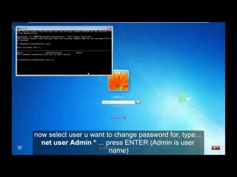

Hey no cd needed you need only to trick the cmd:
http://www.piotrbania.com/all/kon-boot/
I always boot a linux disk, mount that windows partition,
make a copy of sethc exe and replace it with cmd exe
Boot into Windows again and then you can open your cmd
by hitting Shift button multiple times. Now you can set a new password using net user
