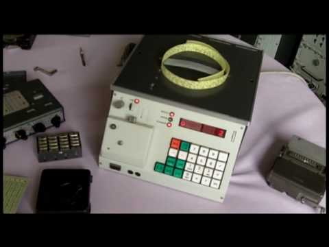

    No, it's genuine crypto and there are many real-world systems based on it. OTP is truly unbreakable cryptography, as in "information theory proven", or "secure against even adversaries with infinite computational power". The Wikipedia article gives more details, as well as problems.
    https://en.wikipedia.org/wiki/One-time_pad
    So why doesn't everyone use it? It's enormously cumbersome to implement. For example, if I want to send you a 4GB message, I need to have a 4GB key. Even more annoying, you have to have the exact same 4GB key, and we can only use it exactly once. If I reuse any part of the key, the entire system is quite trivial to break. And of course, keys have to be synchronized. Plus all the usual problems of generating high volumes of truly random data. And if I don't have a secure communication system, how do I get you that 4GB of key?
    Now if you're the NSA designing a system for the US embassy in Moscow to talk with Washington and you can send a practically infinite amount of keyspace in diplomatic pouches and have battalions of Marines to guard everything, or if we're talking about a nuclear sub communicating with the pentagon, etc. - then yes, OTP is truly perfect. However, in real world applications, public key crypto is much, much easier to implement.
    I linked to the Venona case, which is a famous case of an OTP system being compromised by key reuse (in this case, back in the pen-and-paper days of the early 40s when the Soviets were reeling under German invasion).
    Thanked by 1ricardo

  • Nope, at least not in the case of a submarine. Simple reason: usually very limited connectivity.
    That's where high quality and verified/proven to spec pseudo random generators enter the game, or more precisely, a set of those. Well noted, I'm not talking about a pimped up mersenne twister.
    Plus frequent and irregular shifting using another prng.
    Example: You have, say 129 prngs, the first one feeding the driver, which is looking at each random string created and, based on some algo with good irregularity, choses one of the 128 other prngs to create the next x bytes of random.
    As both sides have the same setup the decisive factor is a (true) kickstart random that is transferred at the start of a session (encrypted) so was to seed first the driver and then all the other prngs.
    It's a classical space vs computation trade-off that makes sense for two reasons: a) practically (due to computing power being available) and b) in terms of OpSec as you want a good setup/payload ratio and small startup data exchange.
    Where an OTP, albeit for other reasons, comes into play could be the encryption keys for the startup value. This at the same time offers some form of multiple factor crypto.
    Depending on the universes of the prngs (typically larger than 2^1000) this provides near OTP security plus good ratio, low overhead, multi-factor and high flexibility.
    bsdguy said: Nope, at least not in the case of a submarine. Simple reason: usually very limited connectivity.
    I'm sorry, but this doesn't make sense to me.
    First, you may be thinking of the old ELF days, where it could take 15 minutes to send 3 characters. Subs on VLF chat at about 300 baud today. That's...135KB an hour? That's a good sized document.
    But regardless, what does the bandwidth matter? You're got to encrypt it with something, no matter how small it is. Since you already have a very secure means of key exchange (assuming we consider the US Navy to be secure) and the personnel to manage things (not to mention the NSA to design it all for you), there's no reason not to use an OTP scheme.
    BTW, those limitations are underwater...submariners have been sending and receiving email for decades.
  • @raindog308
    I didn't say that OTP is somehow bad. But you see, it's not just 1 transmission. As for the navy (or any military for that matter) don't ignore how they tick. They wouldn't like to be fixed to a single prepared OTP list, they want multi-factor and Plans B, C, and D. Also keep in mind that much traffic is needed alone for housekeeping and only a part can be information payload.
    The most important argument, however, is that good pseudo-random is indistinguishable from a OTP (which is pseudo-random, just put in a list/file/whatever) but not fixing it offers quite some attractive advantages, some of which are extremely important, such as "even the officers aboard don't know the OTP".
    I guess the decisive factor is the availability of plenty computing power in small packages.
    That said, maybe you're right anyway. I was just thinking loud and considering some factors that are probably not unimportant.
