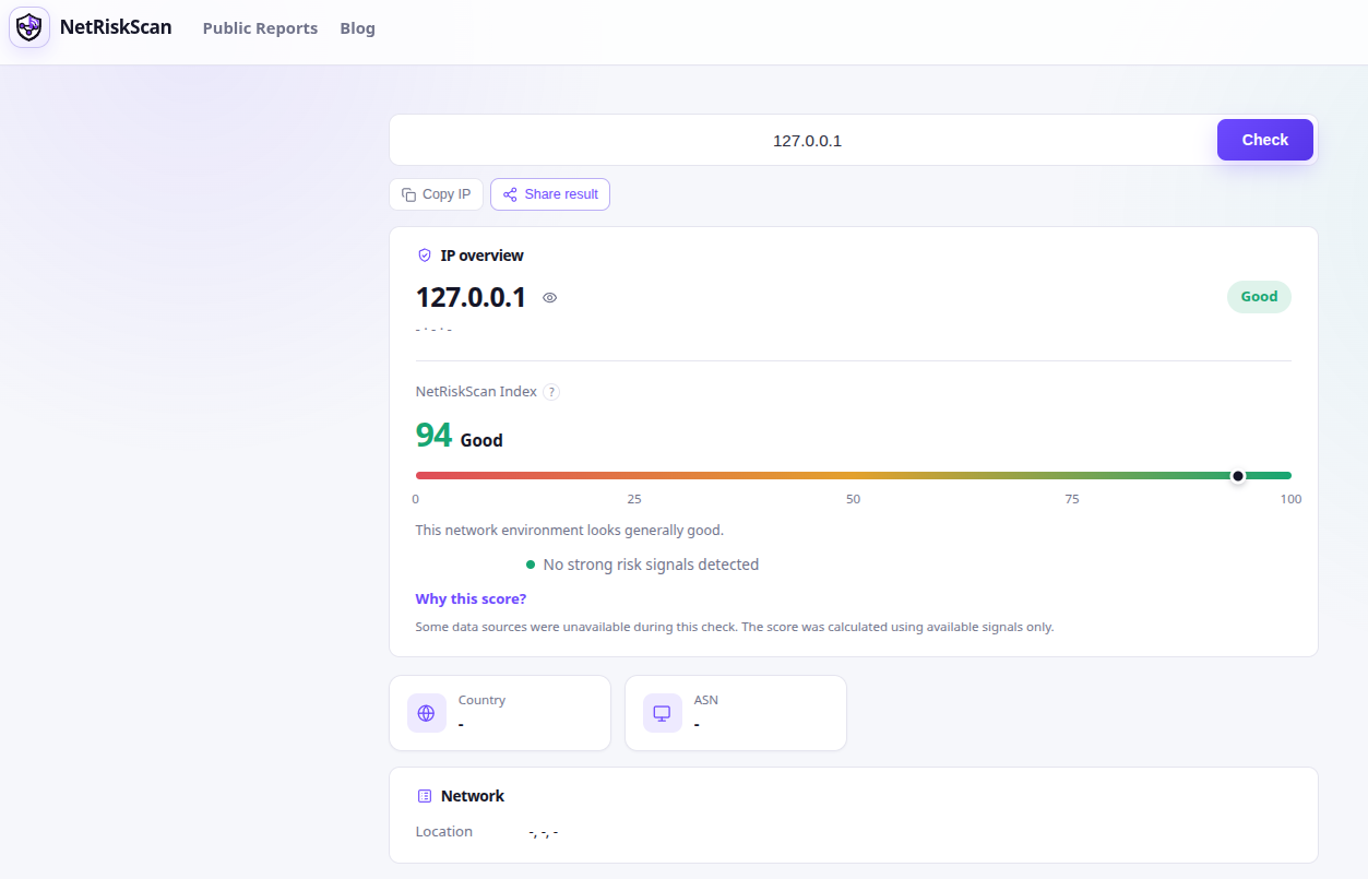

  • This site is irrelevant, nobody is using it and their methodology is not transparent.
    IPQualityscore, FraudCheck, Scamalytics, are those kinds of services that platforms
    integrate for their "dirtyness" detection.
    If a service determines that an IP is dirty because it's a datacenter, they can GTFO.
    Thanked by 2forest rpqu

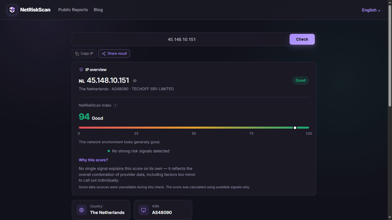

    @yangqq753
    I just checked seven of my infrastructure servers and all got scores between 92 and 94, and 2 of those servers very highly likely do not have good IP rep.
    Sorry, but something with your scoring seems to be quite off.
    Please explain the logic of your scoring system.
    Thanked by 1yangqq753

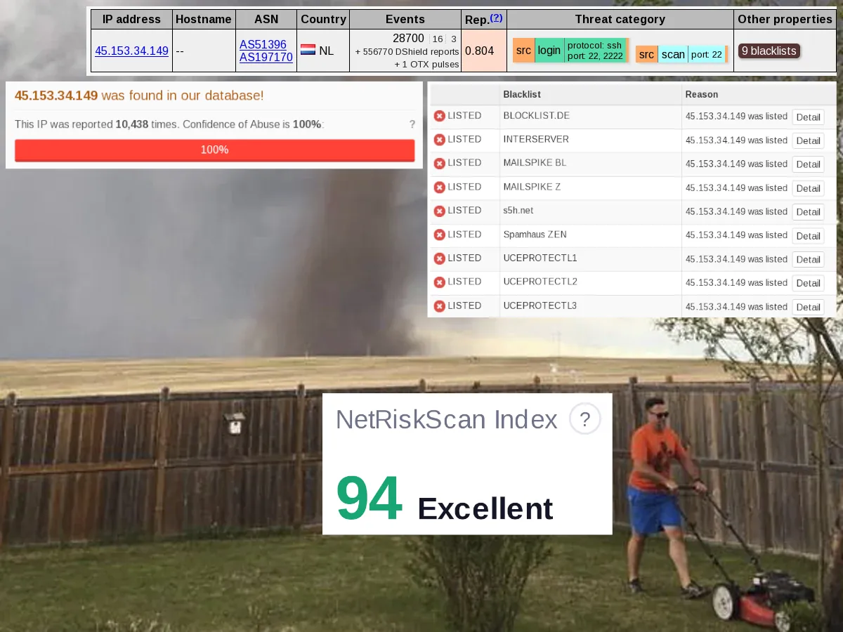

  • olokeoloke Member, Host Rep
    @yangqq753 said: Before deploying anything, I usually want to know whether the IP already has a bad history.
    What does this tool do exactly?
    It fails to properly identify IP addresses actively scanning the internet, with thousands of reports on other sources. Taking 45.153.34.149 or 80.94.92.179 as an example.
  • ralfralf Member
    69.69.69.69?
  • @jsg said:
    @yangqq753
    Thanks for testing seven different servers — this is exactly the kind of feedback I was hoping to get from LET.
    I agree that having all seven results clustered around 92–94, especially when you already know that at least two of those IPs have questionable reputation, suggests that the current scoring model is not differentiating risk strongly enough.
    The current NetRiskScan Index is a 0–100 cleanliness score — higher means cleaner. Internally, it normalizes signals from multiple IP reputation/network data sources and combines things such as proxy/VPN/Tor detection, hosting/network type, abuse/reputation signals and other IP characteristics.
    Your test has exposed a weakness in the current aggregation: ordinary/neutral signals can currently dilute stronger negative reputation signals too much. I'm changing that so that strong evidence such as confirmed Tor exits, open proxies, active/recent abuse and multiple independent reputation flags has much more influence, while simply being a datacenter/VPS IP will not automatically make an IP "dirty."
    I'm also adding better handling for unknown/unsupported data and provider failures, so missing data won't accidentally be interpreted as a clean signal.
    I don't want to publish a precise weighting table yet because I'm actively changing it based on these real-world tests, and I'd rather not pretend the current formula is more mature than it is.
    If you're willing, I'd be very interested in the two IPs you mentioned that you believe have poor reputation. They would make excellent regression cases — I'd like to compare their current scores with the revised model and post the before/after results here.
    Thanks again — this was a very useful test.
    You're right — 94 / Excellent for that IP is clearly not a good result.
    NetRiskScan is intended to answer a fairly simple question: does this IP/network environment currently look clean or risky? It aggregates several reputation and network signals into a single 0–100 index, rather than just checking whether an IP is a VPN/proxy/datacenter address.
    Your examples expose an important weakness in the current implementation.
    An IP with active scanning activity, thousands of abuse reports and multiple blacklist/reputation signals should not be able to end up at 94 simply because other neutral signals look clean.
    I'm currently reworking the scoring model so that strong evidence such as:
    • active/recent abuse
    • scanning/brute-force activity
    • confirmed Tor exits/open proxies
    • malware/botnet indicators
    • multiple independent blacklist/reputation signals
    cannot be diluted by things like normal GeoIP/ASN/hosting information.
    I'm also reviewing the data coverage itself, because if the upstream sources currently used by NetRiskScan don't expose enough active-abuse/scanning information, changing weights alone obviously won't solve the problem.
    I'm going to use 45.153.34.149 and 80.94.92.179 as regression cases while working on this.
    Once the revised scoring is deployed, I'll retest both and post the before/after results here.
    Thanks for providing concrete examples — this is exactly the kind of failure case I need to find.

    Sorry, I kind of take back what I said after taking a closer look at IP reputation sites and came to the conclusion that they can hardly be trusted and/or are weird and based on "gut feeling", plus they address different audiences. Examples:
    Scamalytics (somewhat famous) seems to be largely based on gut feeling ("their impression from the whole IP range"), of course intransparent.
    IPChecker does at least list a plethora of Spam/block lists but I got only results from 11 to 12 ("good") with one single exception, a @DeluxHost VPS with a result of 13, based on the fact, that it's listed on 2 "bad" lists instead of only 1 - which opens another can of worms because most of those lists like e.g. Spamhaus are between questionable and pure crap themselves).
    Scamalytics, while seemingly mainly focused on mail server admins at least has a broader variety of results, from 0 (good) to 50 (bad, but not dangerous), but unfortunately tell very, very little about how it comes to its conclusion/result.
    Finally, I also tried Talos (from Cisco AFAIK) which however does not present a TL;DR result but only kind of a filled in "form".
    To round it off I also checked for 151.242.30.113 (a known TOR exit) and got those results:
    Scamalytics said zero risk, although it clearly recognized the TOR exit and a few black lists - ridiculous and worthless IMO.
    IPChecker did its job and said "high risk", score 61 and also showed "red" black lists.
    Talos did say "Added to the Block List Yes" and "Classification tor_exit_node" but without any clear risk marking - also worthless IMO.
    IPChecker is the only site I know that provides a quick IP reputation check with a clear risk TL;DR and immediately visible. Unfortunately their scores mostly are within a quite tight range and seem to follow the "logic" 11 + number of "bad" listings.
    So, a tool/site like yours actually might be quite useful - but, and that's a big but! you absolutely need to clearly and transparently lay open your scoring algorithm!

  • @ScreenReader said:
    should i be concerned?
    Bro leaked his ip. 💀
  • @mrerenk said:
    "Big mistake... now I can access my own local server! 😱"
    Thanked by 1mrerenk
    "FBI, OPEN UP! He's hacking 127.0.0.1 right now!"

  • itzsenuitzsenu Member
    edited August 19
    nice tool. Working perfectly. one of the latest highest thread IP is 94% good.
    "This IP was reported 446,161 times. Confidence of Abuse is 100%:"
    So what's the database that the Artificial Intelligence selected?
