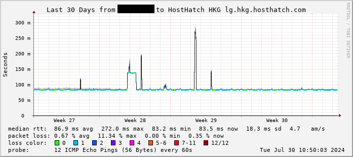

  • Tencent cloud Shanghai to HostHatch HKG, acceptable since they have no guarantee, my 2 cents
