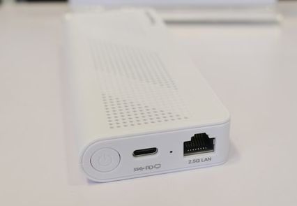

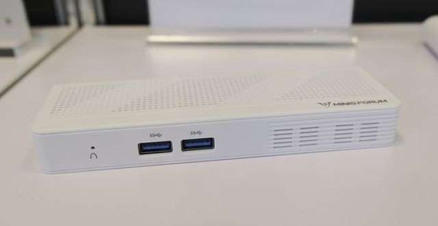

@PulsedMedia
Have you seen this? Strip it down and make a custom snap-in tray that mount it vertically would make great density. With PoE it would only require 1 RJ45 each.
What is that?
Sorry, I forgot to add it's the new MINISFORUM S100-N100. Not yet sold, it's have an N100 and 2.5Gbps PoE, in a thin and long form perfect for clustering. I'll be keeping an eye on when it's available as I will need a small test cluster soon(TM).
Interesting. Couldn't find dimensions for it tho. Guesstimating 3 of them would fit into space of mITX.
